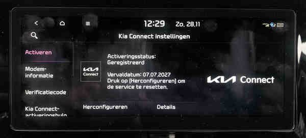

Gerd_NL Posted November 28, 2021 Posted November 28, 2021 You have also a reconfigure in the KIA Connect app in the car: Quote
