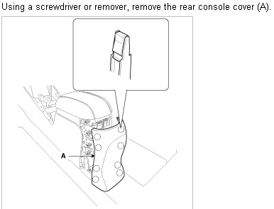

oparobbie Posted September 30, 2011 Posted September 30, 2011 Hello Everybody in this great Forum I want to put a 12 Volt socket in the rear of the middle console for my Kids at the back seats for portable TV´s. Does anyone removed the middle console ? Tips or Picture or HowTo would be great. Greetings from Mannheim Germany Thanks a lot Thomas Quote

bowie97 Posted October 3, 2011 Posted October 3, 2011 Sign up for a account at WWW.KIATECHINFO.COM It is free and there is a lot of information. And than Look here And here You get there stuf like this console.pdf Quote

oparobbie Posted October 4, 2011 Author Posted October 4, 2011 @ bowie97 Thanks a lot :) That is what i need Greetings Thomas Quote

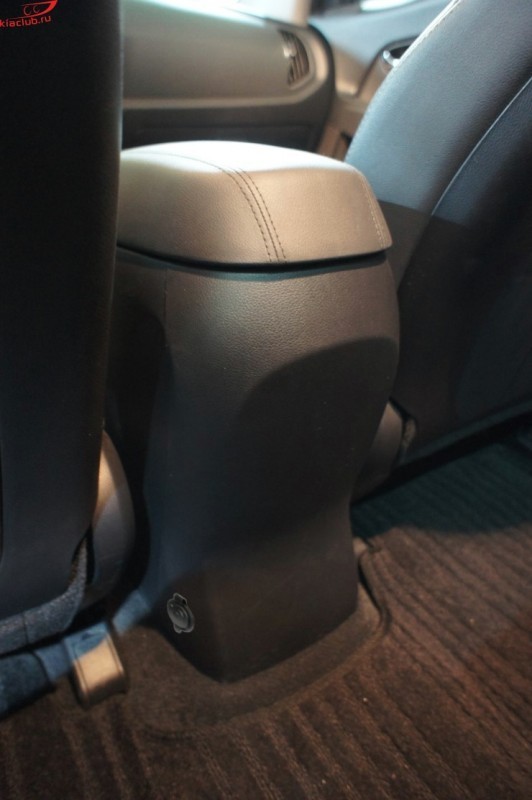

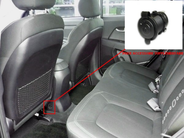

bowie97 Posted October 28, 2011 Posted October 28, 2011 Iets gevonden over dit onderwerp op een frans forum De bijbehorende 12 v plug hier gevonden Of hier nog goedkoper Het reslutaat mag er zijn. Quote
